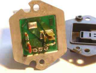

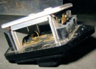

The fans only at level 4 makes it sound like the Climate Control type (electronic) and where the speed control transistor has blown, on level 4 the transistor is bypassed by a relay for full speed. If its the older style, then all the thermal fuses bar the fastest speed have popped! and need soldering back down again!
The transistor is available here http://nikkoe.com/catalogsearch/result/?q=2sd1525
and the module is under the middle of the window screen under a cap behind the X02 fuse box - red arrow.
