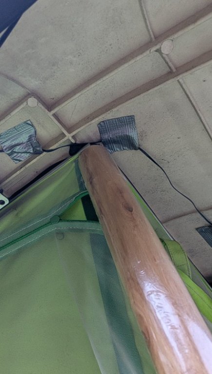

Did this today, following advice above. Very much appreciated.
Removed 5 screws from the pulled out inserts, one screw was destroyed so I glued it and lowered the roof carefully onto wood to force it up and hold it in place until cured. JIS screwdrivers are mandatory.
A little more difficult than I expected, hands/fingers still hurt! Maybe she decided to stop giving me a hard time when i got out the mini baseball bat.
