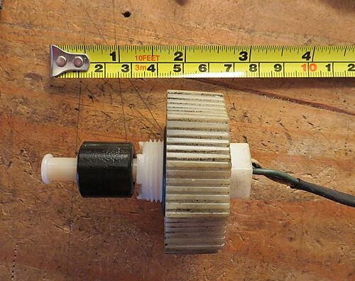

Just had the sediment light come on whilst normal driving. No other warning lights, starting and running fine otherwise. Have read a lot on here about alternator issues, but I don't think it can be that as all electrical stuff seems to be working OK, and no problem turning the engine over from cold or warm
thanks
Posts: 10849
Re: Sediment light but no other lights-mystery?
Post by g8dhe » Thu Mar 12, 2020 11:14 am
In that case it will just be water in the sediment trap, its main purpose, which needs emptying out. Its screwed in at the bottom of the fuel filter,unplug the wire, unscrew and empty.

Thanks all, I hadn't realised that it was all part of the fuel pump assembly. Drained and as expected, a mix of water/diesel came out (caught most of it!) Replaced the plug, and on ignition, sediment light not illuminated. All good so far
Then on starting, lots of juddering, and motor cut out a couple of times. Also (Sort of) expected, as now a bit of air in the fuel line. But how long should this last? Not responding to throttle at all, and engine just dies on return to idle (now 4-5 times in a row).
What have I missed/broken..??
