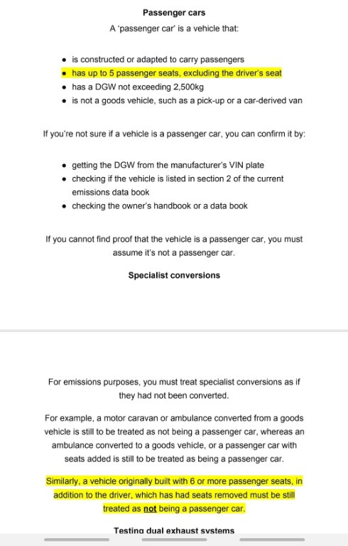

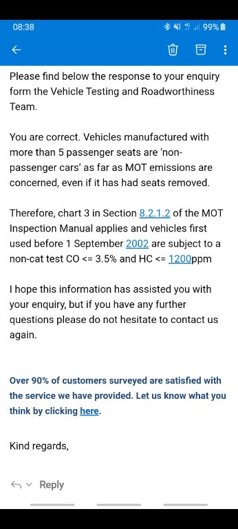

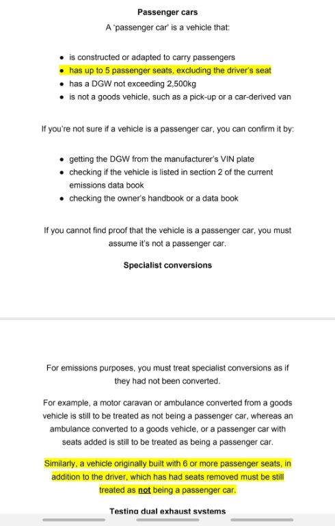

I know it's a bit late now but petrol Bongo's up to 1st Sep 2002 do not need a cat test and should have a non cat test as my reply from DVSA states
https://www.dropbox.com/s/zpty2g3cb35d8 ... k.jpg?dl=0
I did try to upload it but failed so put it in dropbox, basically passenger cars have up to 5 passenger seats, but a vehicle originally built with 6 or more passenger seats, in addition to the driver, which has had seats removed must be still treated as not being a passenger car so subject to a non cat test.
