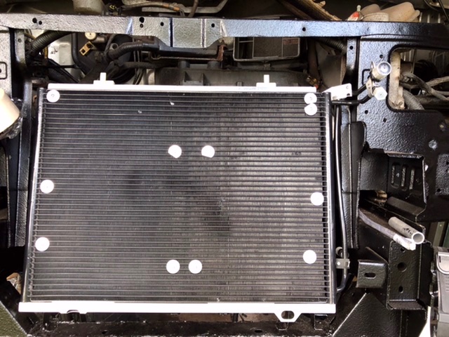

My condenser is knackered so I’ve sourced a Mercedes one that I can alter pipe work on cost was £27
