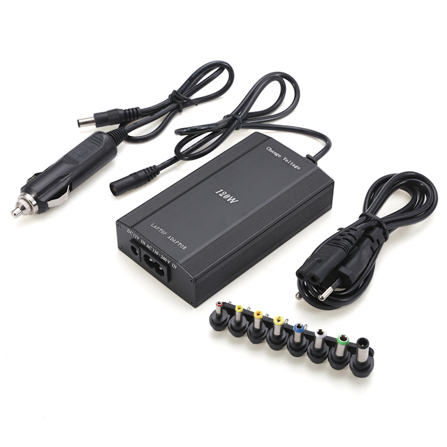

Most Laptops don't use 12 volts they range from 18-23 volts so you get a mains power pack with them to go from 230 vac to the required dc voltage, or you buy an inverter that takes 12 volts dc input and either a fixed or adjustable output voltage to suit your machine, a lot come with "tips" that match the right socket and set the voltage at the same time for the specific laptop;
Devices like the above are designed to handle the wider range of voltages 10-15 from the car and also can handle the spikes to much higher voltages.
