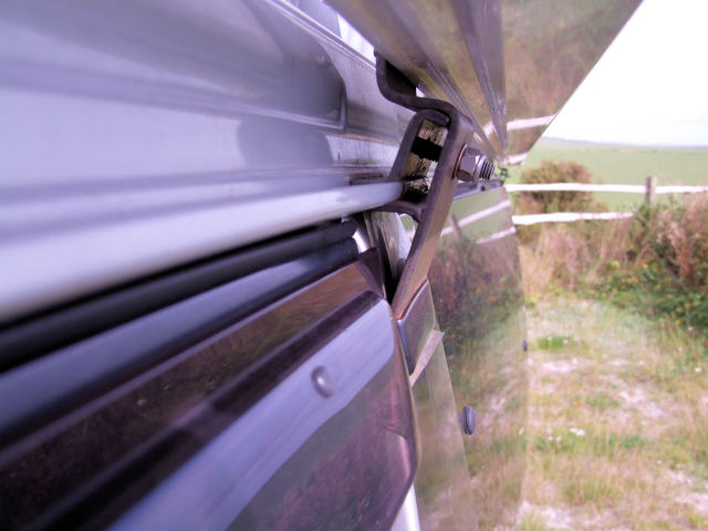

The old T3 brackets for the F45 should have a strip of plastic that protects the gutter and side panel it wraps around the gutter and the hangs down behind the bracket you can just see the end of it in the picture below;
