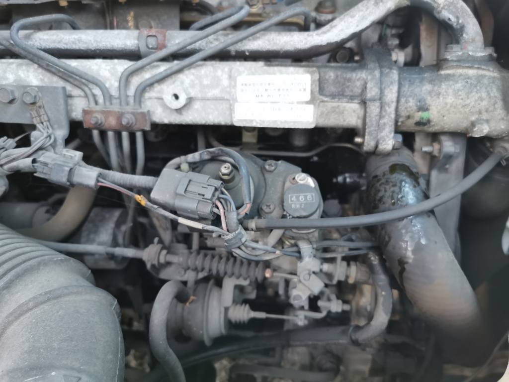

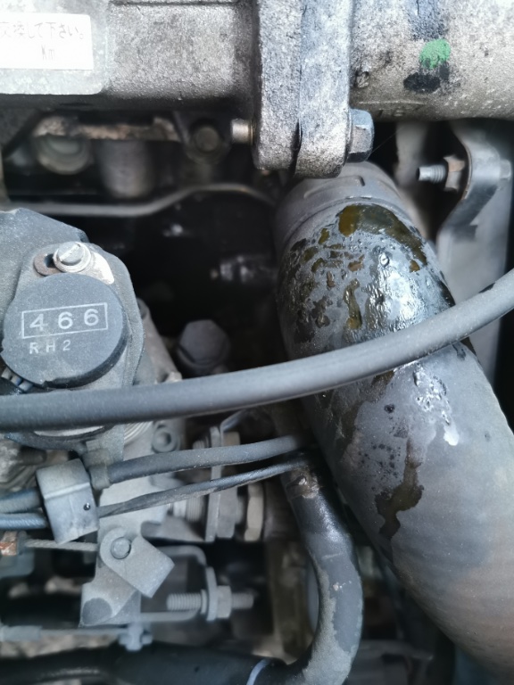

I've no idea where this is coming from :?
Posts: 7724
Re: Can someone identify the part I need replaced? (2.5TD Coolant system)
Post by Northern Bongolow » Sun Jul 12, 2020 11:03 pm
Taste it, sounds weird but it will help.
Looks brown like coolant from the pics, but could be oil.
If it's coolant could be water pump leaking and being lifted by the spinning of the fan belts or airflow, are you loosing coolant ?.
Or could be oil from the camshaft seal or crank seal on crankshaft both again picked up on the airflow or belts.
If you look forward of the leak pictured you will see a gap behind the timing belt cover,engine oil leaks behind this cover may contaminate the timing belt and lead to a belt failure.
Leaking front coolant pipe or rad being blown back to the engine bay also maybe worth checking.

Post by ever after. » Sun Jul 12, 2020 11:46 pm
I think you might be on the right track Northern Bongolow.
When I touched it you could see that the colour of it was orange on your skin so I'm pretty sure it's coolant on top of an old layer of oil.
I had to top up the coolant in the reservoir on two different days during the last 2 weeks which would be unusual.
I topped up the day after it was drove each day as the alarm went off indicating low coolant, only a small amount of coolant was needed either day so I don't think it needs to be bled.

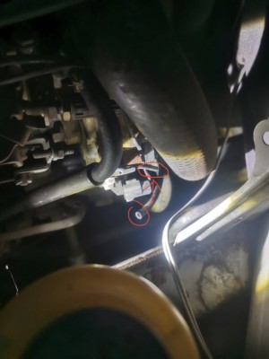

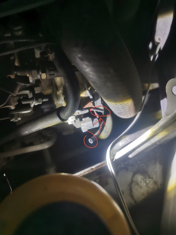

Anyway, I found this when I investigated further.

Post by ever after. » Tue Jul 14, 2020 1:15 am
Northern Bongolow wrote: Sun Jul 12, 2020 11:03 pm Taste it, sounds weird but it will help.
Well that was interesting :shock:
Ehm.. :-k
Full-bodied,
Toasted oil aroma,
Bitter, very bitter :lol:

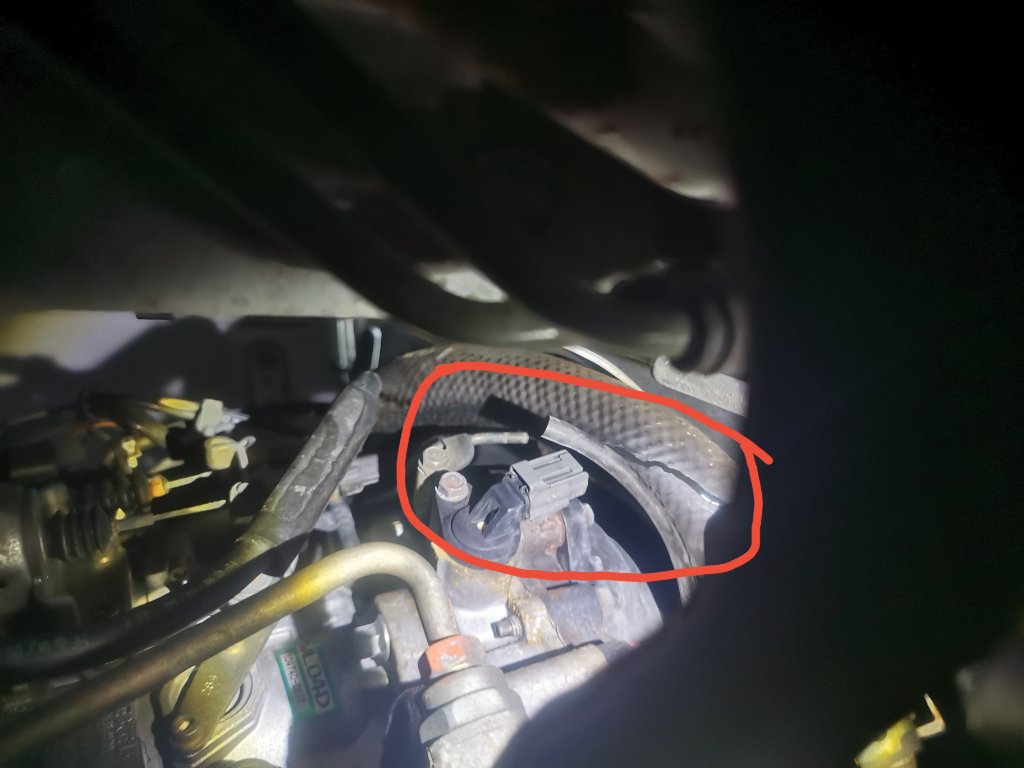

Post by ever after. » Mon Jul 27, 2020 9:45 pm
Looking like it was this tiny little hose, there was a vacuum in it
From the top...
From below...
