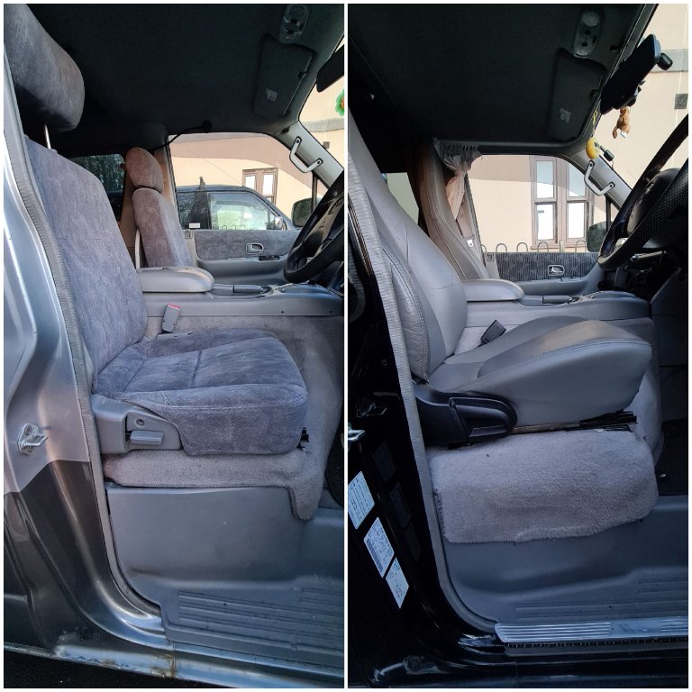

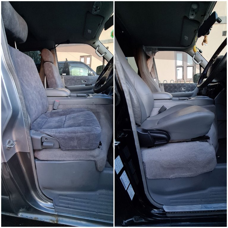

Post by Winnie-bongo » Tue Jun 08, 2021 10:26 am
A comparison picture of MX5 seats and stock Bongo seats
