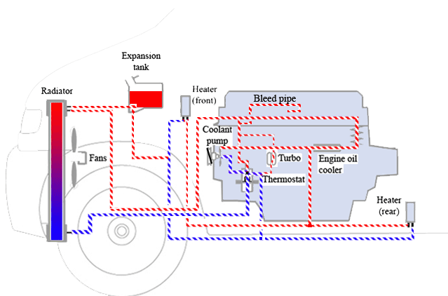

The cooling system is a bit fraught in a Bongo, being mid-engined. The air heater matrices are continually fed engine coolant (control is managed on the air side of things) so if the gauge showed hot and no heat from air con then that suggests a circulation problem, not a thermostat problem. Basically an air lock somewhere and for a diesel that can be EXPENSIVE as its likely to damage the head. Here is a diagram of the coolant system in action;

Handy schematic, thanks
I guess a blockage or air lock would have that effect

Goodness Geoff
That's one neat diagrame.

The diagram is courtesy of Steve Widdowson when he did his original investigations into the cooling system, the posts are still on here. I took a copy of all the images before photosite did the nasty! Hence I can repost them from my server!
See http://www.g8dhe.net/bongo_images/widdo ... /index.php to see them all !
