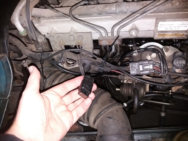

One almost certainly unrelated query, but I found this connector (pictured below), terminating in what might be some sort of sensor, just hanging in space at the end of the pump when I started. It looks like it should clip onto something, but do you know where?

The plug (13-1552) with the resistor fitted is a means of configuring the pump for the vehicle see below for the table http://lushprojects.com/bongopartsmk2/c ... mgno=.html

Thanks for the messages about the connector/resistor. Although its not related to the fuel pump priming problem, at least its clipped back in its proper place now.
