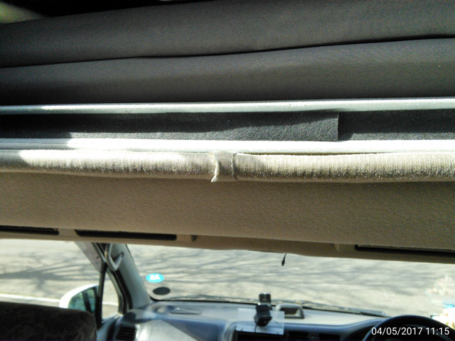

The lining strip around the inside of my internal roof hatch is coming away. It appears to be a black, cloth based, sticky backed strip 18mm or 3/4" wide, but I can't find anything suitable on Amazon or Ebay anybody have any ideas ? Doesn't have to be sticky backed I can always use a spray adhesive to hold it in place but can't see anything cloth based and that width that looks good ....

Looks like iron on hemming tape to me.

Right found something suitable the key search word was "woven tape" this looks like it will do will find out next week when I glue it on though I might try using the iron on hemming tape as well for that purpose as I've already got some of that at 15mm.

And yes I can confirm it works very nicely, used spray fabric glue to hold it in place. Worth using masking tape to prevent over spray of the edges.
