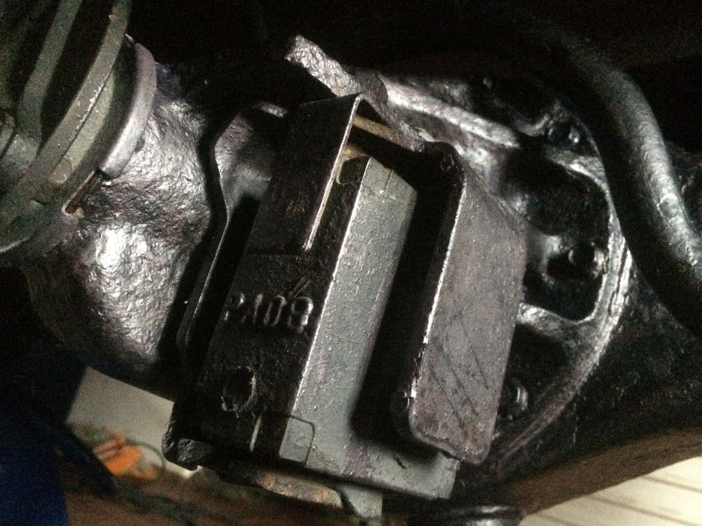

Can anyone tell me what the rubber block is on the rear axle is , at the end of the prop shaft ?

Not noticed anything on mine and not sure what I am looking for in the image but sometime things like this are vibration dampers, Could that be it?

If you mean the rubber block bolted to the diff (to the left of the r/h axle stand) its called a Harmonic Damper, these are used to eat the vibrations caused by the final drive.

I looked under the bus today again and there are two " harmonic balancers " one on the rear of the gearbox and on the front of the rear axle . Both are really a block of rubber bonded to a heavy gauge steel frame and I assume are designed to move with the vibrations of the transmition system to balance vibrations out and ,on mine at least, both rubber bits move but on the gearbox one the rubber seems very easy to hit off the steel frame where as the axle one will move but not hit the steel frame .
Does this sound normal of could this be my problem ?
Thanks in advance

Can you post images of the two you refer to, if they are dampers then its not likely that they are the source of your problem ,if the noise is rhythmically related to road speed then it is more likely along the lines of NB`s post and UJ related, they can have tight spots too.

Post by Merlot man » Tue Feb 21, 2017 11:14 am
Good morning everyone
This is the gearbox rubber block that I was talking about

Post by Merlot man » Tue Feb 21, 2017 11:18 am
And this is the one from the rear axle
Both move but the gearbox one is easier to move than the axle one , does this make any sense to anybody
I still plan to have a proper look at the prop shaft , maybe by a local mechanic
