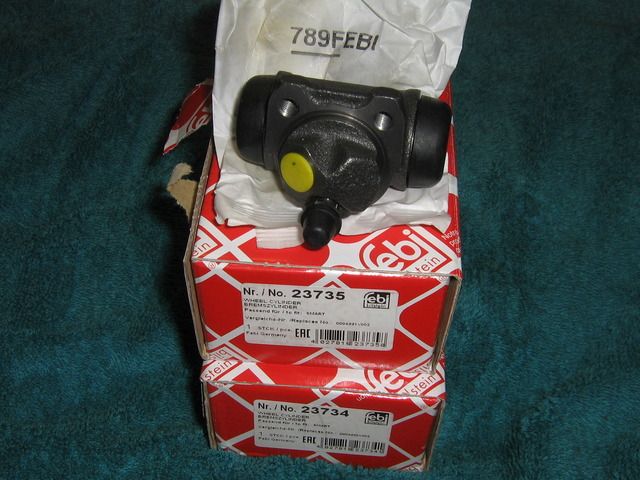

Just ordered one as my sons Smart car rear (drum brake) wheel cylinders are seeping and rather than re rubbering them we have bought two new complete ones to replace them...
