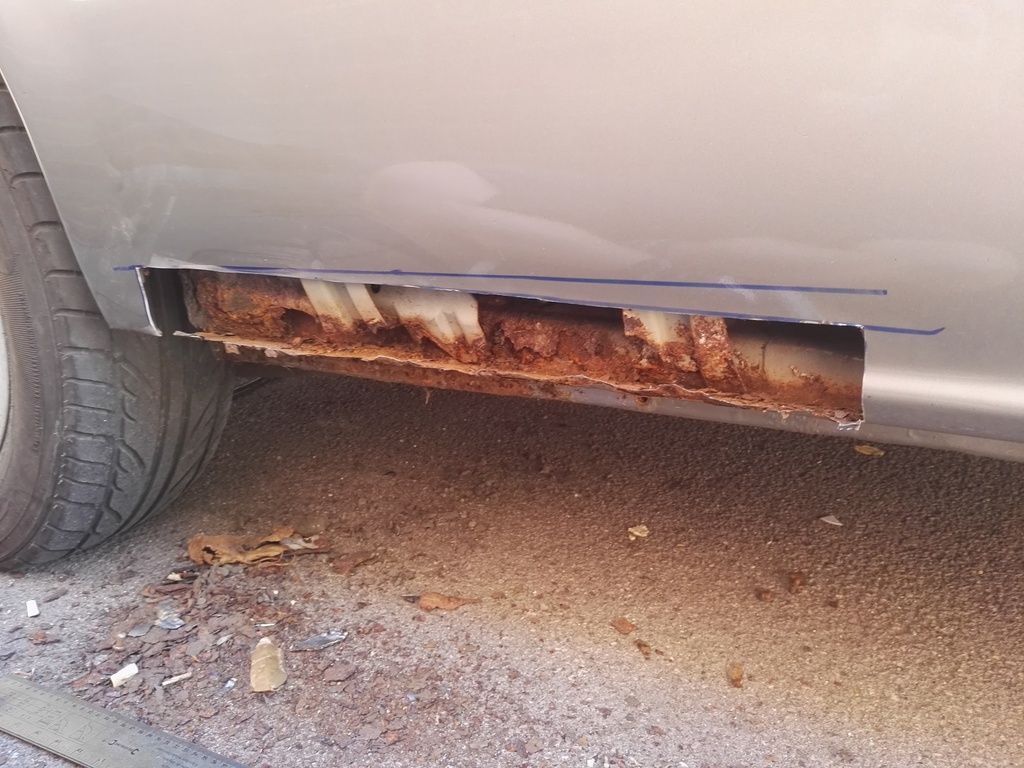

Having had the MOT man tell me last December that he passed the van somewhat generously with welding (i'm sure because he didn't fancy it!) I have finally got round to starting it today. Planned to do it in August but life got in the way.

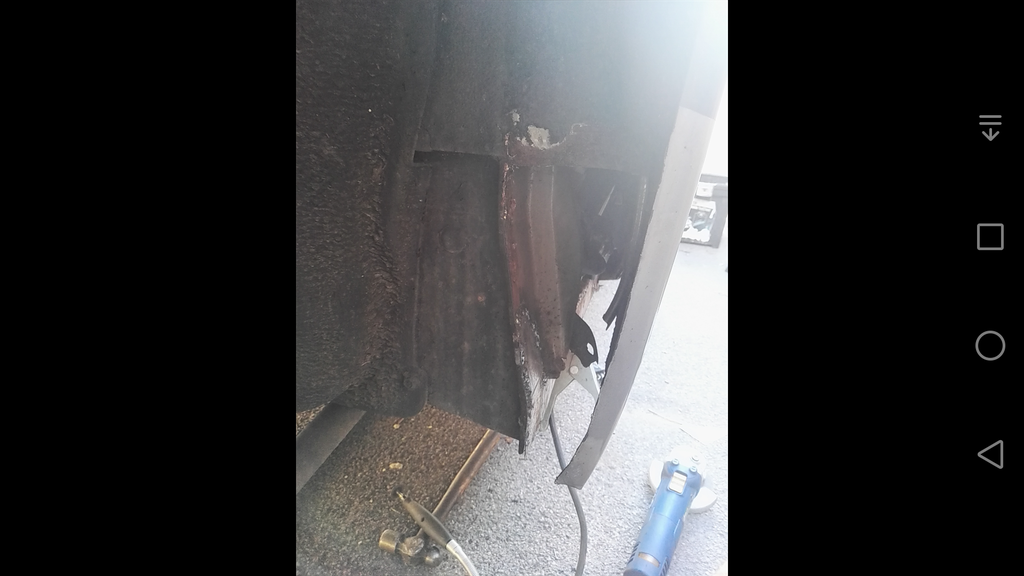

As is the way with these things, only once you start cutting it out do you really find the horrors within. Having recently had Morris Minors and Triumph Heralds, i wasn't too alarmed, but still, pretty depressing!
Rear arches have been replaced in the past and are holding up well. I did have a look at thr replacement outer sills, but they do not appear to go high enough to cover how high i have had to cut it out. It had been liberally seam sealed to cover some holes, but that is all cut out now.
It was a very difficult panel to fabricate, i am an events manager/hobby mechanic, so it won't be the prettiest. But, it will be strong and will last for some years yet.
Took bloody ages though and not nearly finished.
Out of curiosity, how much would you expect to pay for this job? Bongolia, you're the chap in the know!
I'll post some other pics when it is all done!

Makings of a pukka job there Callum. I would put that with fabricating panels and modding an outer sill at around three days to get it levelled for prep & paint so 24 hours @ whatever rate charged where you are
Plus materials and sundries.
What outer sill did you use?
From what vehicle?
Nice to see what behind the panels. I am sure a image database would be useful for others on here too.
Good luck.

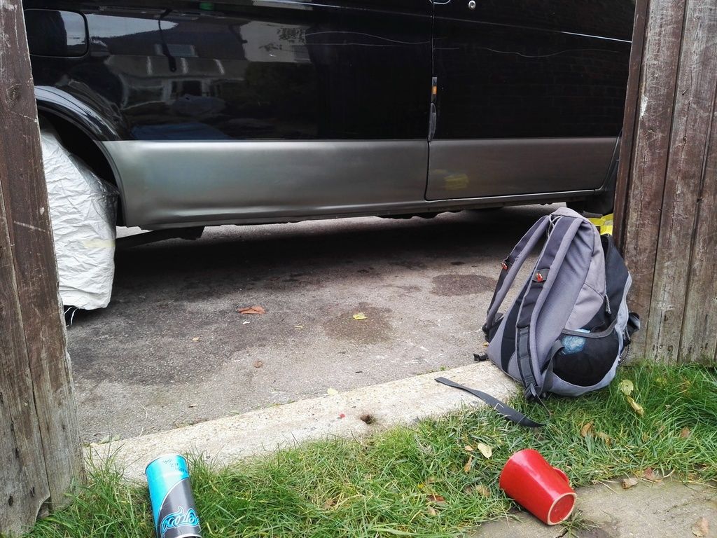

Post by callum » Mon Oct 17, 2016 8:34 pm
First coat if primer to get a feel of the finish. It isn't perfect, clearly, but is getting there. The edge i made in the panel is a bit more pronounced than the original, but hey, i'm an events manager, not a fabricator, so it'll do.

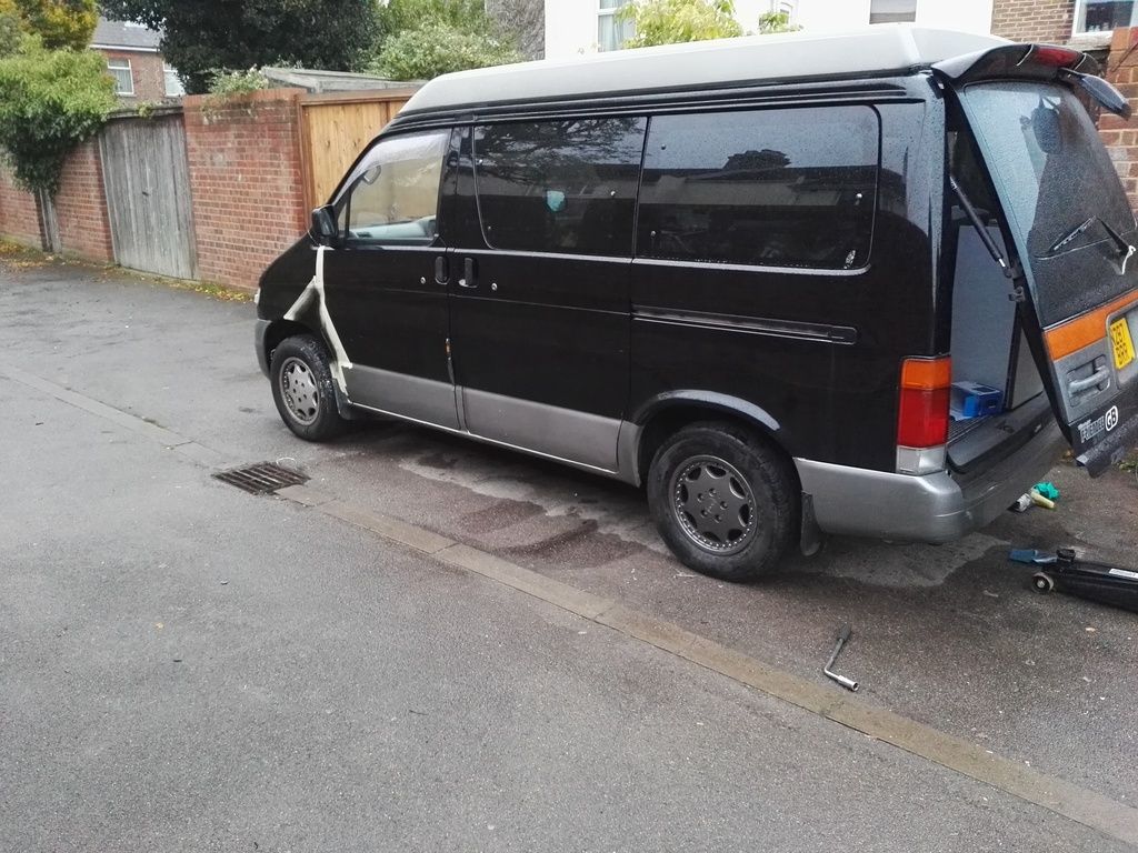

Well, i finally got a chance to do some top coat on the repair
It's not perfect, but i'm really happy with it. Compared to what was there, it looks and feels a whole lot better!
I did a couple of other bits too, in anticipation of the inevitable sale.
Paint had all started to come off the wheels, so i had bought some paint to do them, so figured i may as well do them anyway. Only managed to do the rears, but i love the anthracite.
I also painted my wipers and the grille, so it is really starting to come together to be a relatively presentable van. Which is good.
Oh, and i did the rocker cover gasket too as it was leaking oil, has been for a year, but it was down the list. Relatively simple to remove the centre part of the engine bay/cab, which was a surprise.
