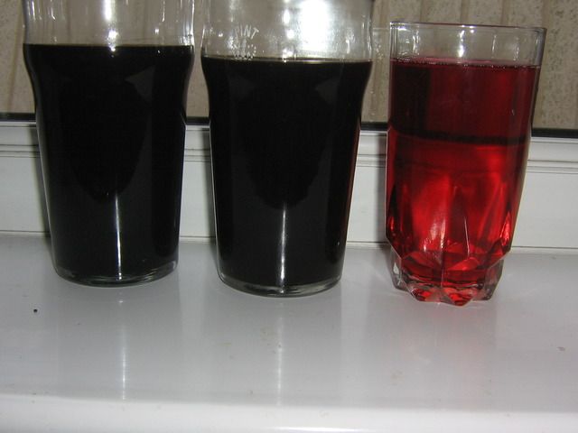

Hi,
i recently did a ATF (Automatic transmission fluid) change at the shop (not a flush), the mechanic at the garage informed me that there was no problems with the transmission, they also dropped the pan, then did the change.
when i got the bongo back i checked the colour of the fluid and it was still brown, like they didn't even change it.
i am wondering if i should change it again? or leave it? it is a light brown right now. before the change it was light brown as well.
when i did a change in a different car, the fluid became bright red.

There is more fluid in the toque converter than the sump ..
This is my V6 Alphards fluid .. left old fluid .. middle after changing the contents of the sump and re filling with fresh .. right fresh unused fluid ..

Hi,
Thank you for the helpful picture.
so i am guessing there is no need to change it again?
