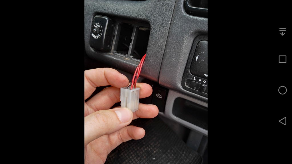

The plug for the internal switch is indeed dangling behind the dashboard, the relay won't be fitted and it seems from reports that some but maybe not all of the wiring loom around the front might be missing (or maybe wasn't spotted) from previous reports.

Good news that it should be dangling there, i shall have a gander. Which side of the steering wheel will it be?

Hi folks,
Can you confirm thst this is the plug?

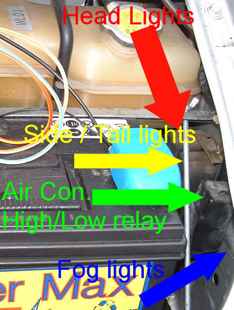

What about the relays then? They were no where to be found in the inner wing. But i assume the lights are on relays, even on the older Bongo's? I just wonder if i can connect an original fog light switch to the plug i pictured, and then route new cabling down to some aftermarket fog lights (some with DRL's in them too, to be wired up correctly of course!) It would save a fair chunk of the wiring/tidiness if i could do that and keep it looking relatively stock within the cab.

Posts: 10973

There are positions for four relays on the inner wing let's see if I can find the pictureImage

As i said, and with accompanied picture, there are no relays there. I have that pic saved already, which is why i was puzzled that i don't have any relays in the position. I just wondered if they were moved if it was A) an old bongo like mine B) a twin battery thing.
Just seems odd that none are there, but they may juat have been bypassed and i shall check soo.
Posts: 10973
Re: Front fogs
Post by g8dhe » Thu Jun 23, 2016 11:07 am
Oh right, never seen that before, however people have sometimes replaced relays, but that is the same for all years versions but sometimes not 4 are fitted but always a couple so odd!
