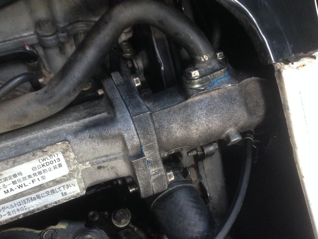

not necessarily easy to see as typically a washer/gasket is simply replaced by a blanking plate.
Here is obvious evidence (blue sealant) of "tampering" (= EGR blanking by me) at the inlet manifold end of the EGR pipe where it joins the manifold elbow. The blanking plate is brighter than the gasket it replaced.
The other end of the EGR pipe (the curvy one in the pic) is a little more buried but is blanked off exactly the same way. It does not have to be blanked at both ends.

Allan, Plymouth, does these plates for a very fair price. :wink:

with nice instruction sheet as well. Anybody doing the job just needs to go carefully with the bolts into the inlet manifold elbow, in which the threads strip oh so easily.
