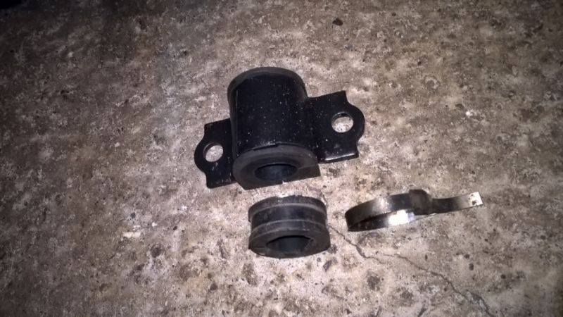

I've removed and repainted the front ARB.
There were the usual rubber bushes and clamps, but also there were two round rubber things around the ARB next to the bushes. These are held on by metal straps. So,
1) does anyone know what function they perform?
2) does anyone have a photo of the ARB and bushes in position, as I've forgotten which side of the bush clamps the round rubber things go !!!
Many thanks !!

On the diagram 34-151, you can see two rings at either end of the straight bit of the ARB. These are the rubber rings I am talking about. The rear ARB doesn't seem to have them. Could they be bump stops to prevent the bar contacting the framework behind it?
Here is a photo. The smaller ring of rubber is pictured next to the ARB clamp/bush for comparison. The metal clip to hold it on is next to it.

Doesn't look standard.

Simon Jones wrote:Doesn't look standard.
But they are shown on the schematic 34-151 so they must be. Doesn't anyone have these on their van?

part 34-151 is one piece, all metal from memory. 34-155 and 33-156A are the expected bush and bracket. Can't see your extra bits on diagram! Does your bar have lumps where those extra bits were clamped?

I think they are standard fitting on a lot of ARBs as stand off or buffers,the diagram actually shows them but no Part Number or item number.
PS they should be fitted to buffer end motion of the bar.

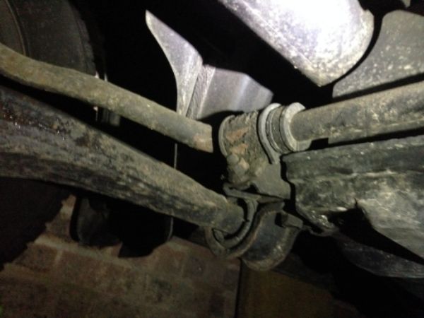

Yes, I've concluded that they are part of the ARB. They are rubber position clamps. I'll need to measure the distances on the bar to make sure I put them on in the right place.
Here are pictures of them on other vehicles:
https://robrobinette.com/antiroll_bar_bushings.htm

Post by Gripped » Thu Dec 03, 2015 11:53 pm
Thanks for the pic !
Refitted mine tonight.
