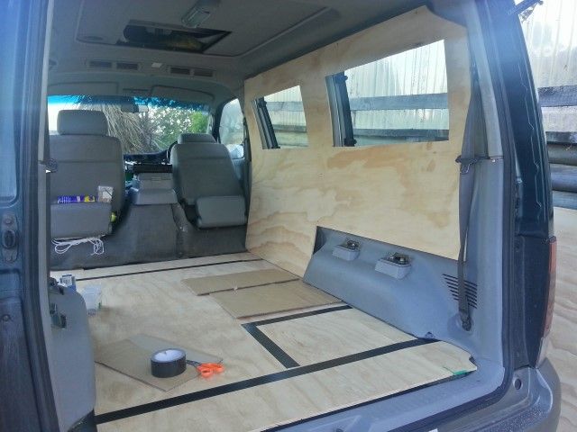

Right Bongonauts, I've finally (finally, finally) started my full conversion on Buddy.
A few points to note at this early stage:
1> How did I miss (I assume someone's mentioned it on here) that the middle row of seats is so heavy?!?
2> Decent wood (Ply) is expensive in NZ
3> I don't know why I didn't do this before, it's starting to look great!
4> I went for a 'front' conversion... the kitchen area is right behind the cab.
5> Thank frig for the blinds... only 2 pairs of curtains to sew :lol:
Anyone got any solid advice, not mentioned before on this forum before I start sealing/screwing/nailing everything into it's final resting place?
Here's an early shot of a pretty sad and empty looking Buddy, I'll continue to post photos here if anyone's interested :)

More progress made over the weekend (see photos) ... the framing of the main seating area is almost complete... starting to take shape now...
I realised that no matter how big (or small) the image of the back area is in your head, its always way off!! I found cardboard (cut to the size of the table or the seating) very useful to help me get a sense of the size of things... also Duct tape on the floor marking out the spaces REALLY helped.
Around 50% of the wood I've used is recycled (mainly the framing) and some other bits I had lying around from other projects. I'm keen to keep with the recycled theme and as such I'm looking for a cool, stylish idea for the sink... I'm going to plumb it in to 2 x 25 litre water containers. I was watching an episode of Amazing Spaces a while ago and some guy had put his sink in a drawer so it was all neat and hidden away, it was cool, but I reckon it would be a real faff no? Will a washing up bowl with a hole cut it reeeeally be enough? All ideas/options considered.
Ta
"Tents aren't soundproof" - '95 2.4DT AFT - "Buddy"

Yeh, fiddly but hopefully it will pay off....I was doing a bit of googling before this project and saw a few campers with 'wooden walls'... we're right into that look.... cosy, woody, warm colours... ANYTHING but grey! We plan on wrapping the internal raising roof in some different material too... less grey, happy us :)
I have to say it has been tricky getting it to fit around all the lumps and bumps of the insides of the van. I removed all handles from the insides to make it slightly more even.... screwed in some batons to help get some straight lines..... and it will mean covering up 2 of the window blind switches but as we're not switching over the power for them to the LB I don't see a problem... we'll just raise/lower them by hand as we always do!

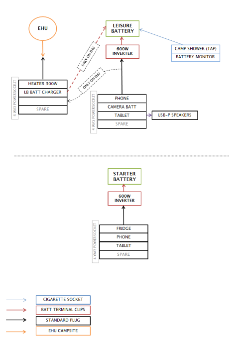

Here's my initial wiring diagram for how I want to set up the power in our van. It may look a bit over complicated but I don't want to do a split charge setup so having my leisure battery completely separate made sense to me... we'll only be 'off-grid' for a day or two so I'm hoping it will last. Then when we get to a site we'll use EHU to charge the leisure battery overnight....
The 'fridge' is just one of those little portable fridges you get from Halfords... it will only be on when driving which is fine because if we're staying anywhere longer we can pop our stuff in the campsite fridge/freezer.
Keen to get your opinions and thoughts on it...
