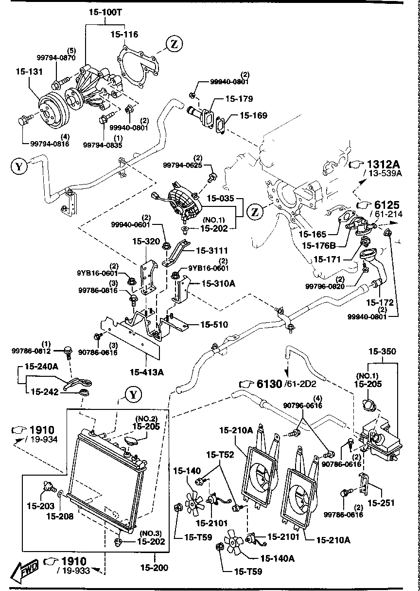

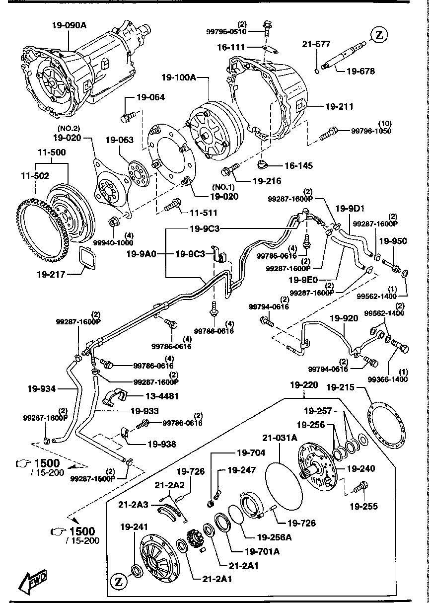

Your radiator, and ATF cooling section are right at the front and would have taken any impact that the bumper itself was unable to resist, so might be worth checking the bumper supports and the two metal pipes leading backwards down the length of the engine from behind the radiator.
http://lushprojects.com/bongopartsmk2/1R10832.gif
http://lushprojects.com/bongopartsmk2/1R10861.gif
