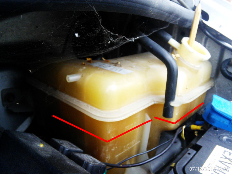

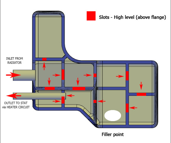

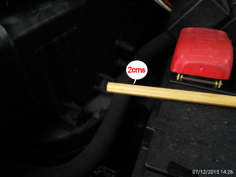

Post by g8dhe » Sun Jul 12, 2015 2:38 pm
Here are images of my tank and results of dipping it;

Post by bongowight » Sun Jul 12, 2015 2:42 pm
Ok thanks ours is about 2cm above that red line when the engine is on but quite a bit lower when cold which is what is puzzling me

Post by g8dhe » Sun Jul 12, 2015 2:47 pm
It will vary between the pressurised hot state and the cool state, the liquid expands when hot and it is this that creates the pressure increase to allow it heat up beyond 100°C, the diesels get to above 105°C and can go up to 120°C if required.
So when cool it will drop down, the concern comes if that level when cool changes by decreasing everytime.

Re: coolant levels V6
Post by g8dhe » Sun Jul 12, 2015 2:56 pm
I wouldn't worry about the high level when hot at all, it doesn't really mean a lot without other info. Just check each morning when its cold and provided it doesn't keep on decreasing then your OK at the 1-2cms level.
