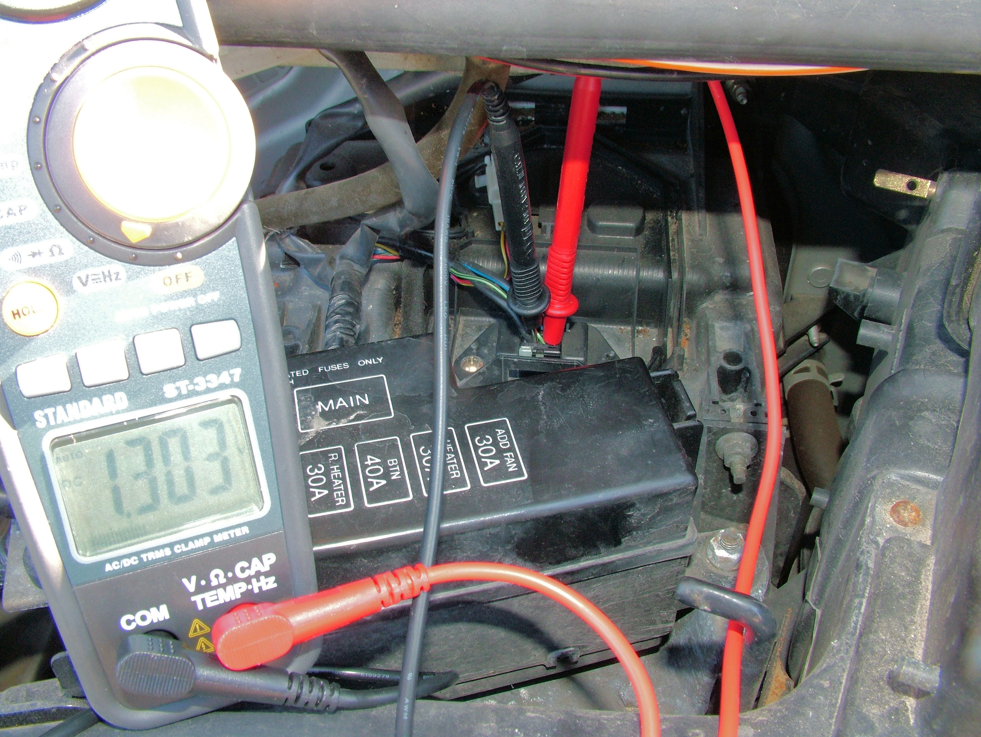

Hi My heater fan only works on no.4 and reading through posts it sounds like the heater resistor needs replacing. Could anyone tell me where this is located as I have looked through fact sheets and cant find it.
thanks
Cas x
Posts: 10834
Re: Heater resistor location
Post by g8dhe » Wed Mar 25, 2015 8:09 pm
Its where the two meter probes Red & Black are stuck in;
remove the screws to get it out.
