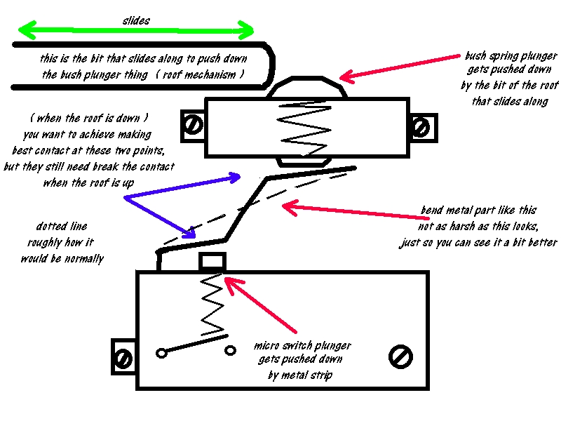

Simon Jones
Posts: 9341
Re: Roof !!!
Post by Simon Jones » Wed Mar 04, 2015 8:18 pm
You can just make out the 'up' switch here on the track. The 'down' version is further forward:

Post by Gripped » Wed Mar 04, 2015 11:42 pm
Great. I think I have fixed it.
Took both of the plastic "buttons" out (manged to lose a spring and a screw, then managed to find the spring on the drive and found a replacement screw in my box of 100000 screws) so I've just fiddled, refitted and they now seem to work. Not 100% sure what was wrong though which concerns me. Amazing that there are switches on BOTH sides, so twice as much to go wrong.
