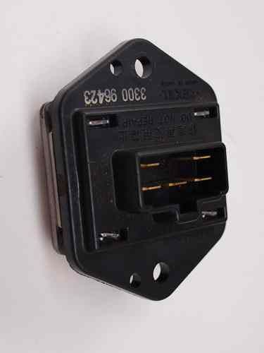

A nice chap at http://www.bongospares.co.uk/ said it may well be a 5 pin resistor that has gone under the bonnet so I am now going to see if I can find that (maybe tomorrow getting a bit dark now)
Ok slightly fiddly but I have the resistor out. If I knew what pins/ohm range to test I could see whether it is broke or not.

This might help someone else so I will post this up:
I will call the pins as shown in the U shape picture above:
1 _ 5
2 3 4
On a 200 ohm scale I read :
Between 1 and 2 I read = 2 Ohms
Between 1 and 3 I read = 1.6 Ohms
Between 1 and 4 I read = 1.6 Ohms
Between 1 and 5 I read = open circuit
Between 2 and 3 = 3.1 Ohms
Between 2 and 4 = 3.1 Ohms
Pin 5 as I have labelled it has no contact with the rest of the pins.
Have no idea what these pins are ! :lol:

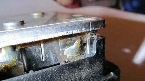

Ok plot thickens. I can see that a solder connection (pin 5) seems to have broken free like a small tinned (soldered) connection has broken free (relative to how the others look)
On closer inspection with a torch I can see a fly has got stuck between the aluminium base and the shielded former (separated by some plastic insulator) that is probably why it overheated and the solder separated.
Photo of said fly forthcoming.

Post by BongoBongo123 » Fri Jan 16, 2015 6:17 pm
Here we go you can just see the fly stuck in the resistor module 45 degrees (north east) from the yellow solder flux blob :lol:
I will take a closer look and see if I can solder the connector back on.

Ok that went smoothly. I removed the fly and also blew another small insect out first then I have some older lead solder with a lower melting point and put a tiny blob on to "tin" the fixed side of the spring type connector and then pushed down the flexible spring side of the connector with a precision screwdriver and simply pushed the connectors to meet with the tip of the iron an instant bond was made and held in place with the precision screwdriver.
Between Pin 1 an 5 now reads 1.6 Ohms.
I am hoping this does the job.
