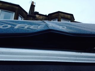

Hi, new to the site and proud owners of our first ever Bongo. The garage we purchased it from left the roof elevated overnight and there was a heavy snowfall. The roof subsequently bent and cracked the edges. Is it possible to repair in the shorterm in a Frankenstein manner as we are looking to go for a hi top in the summer?

suggest you post some pictures

Fibre glass repair kit
From car shops / halfords

A good source of fibreglass cloth, resins and colours are boat builders

Thanks for replies. It was purchased at a discount due to the damage. I'm trying to insert images taken but it appears to be one of those days...

Ouch
If you select all and copy where it says img to right of pic on photo bucket
Should be like this rhen
Could repair that with fibre glass

As its quite close to the hinge, it will have a lot of weight on it so may be worth reinforcing the repair with an aluminium plate on one or both sides.

Are you sure that won't get air rushing in at speed and straining the locking mechanism??? I'd get that done pronto, and my thoughts are the same as Simon. Are you looking at fitting a hi-top yourself?...if so, I think Haydn is the man to speak to!
