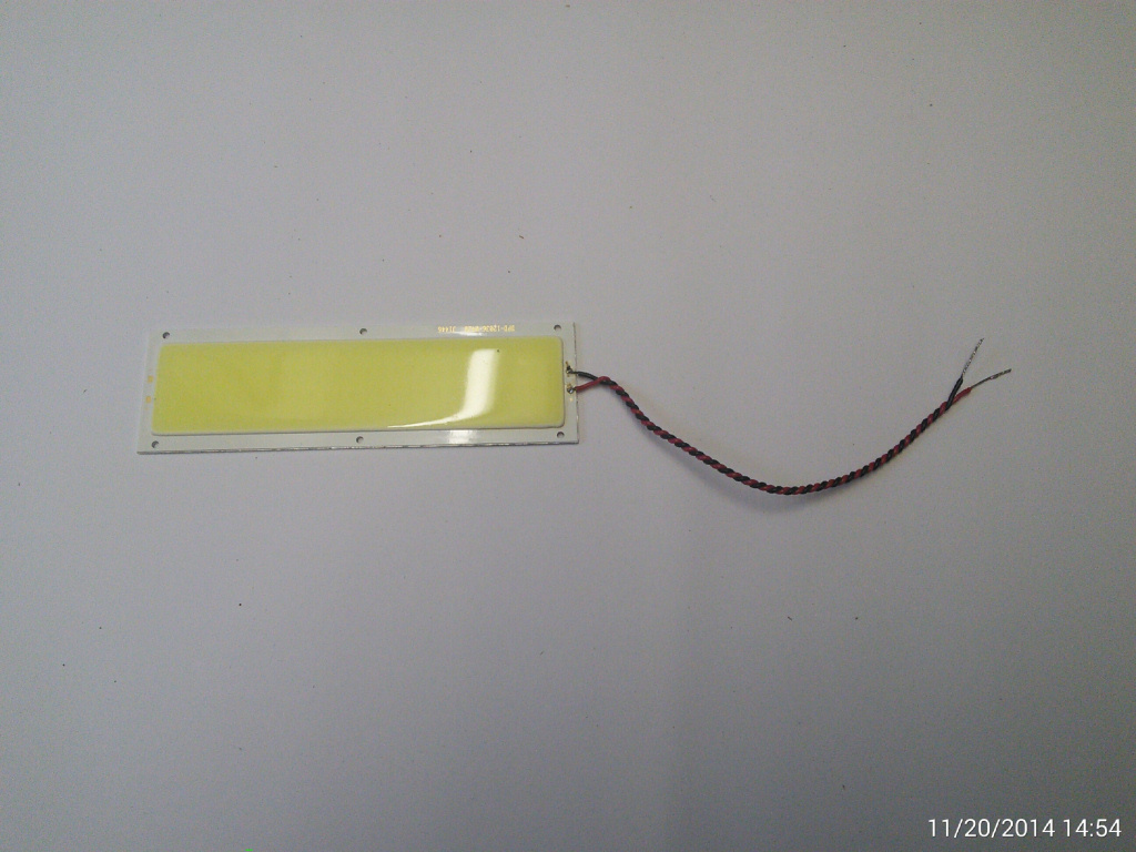

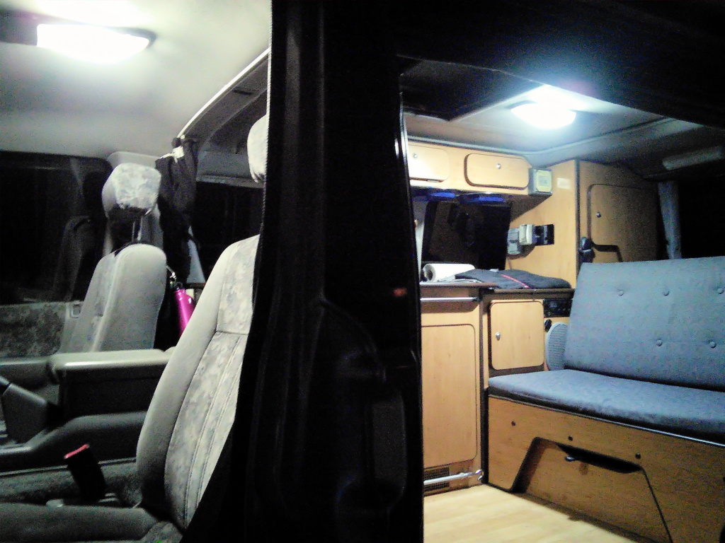

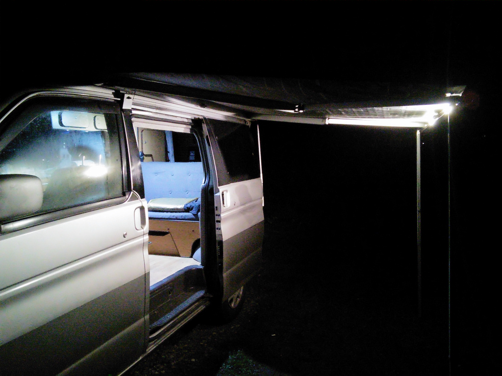

The COB ones are the best as they dissipate the heat better. Just finished replacing our fluorescent lights with COB panels and also a pair in the awning.
On the left is an original fluorescent tube light and the right replaced with COB LED panel
and awning;

Yup each panel takes around 0.4 Amps so less than half of what the fluorescent light takes.

http://tinyurl.com/o5cpal5 for all they stock and http://www.ebay.co.uk/itm/10W-High-Powe ... 8bc201a9bb for the particular ones. The internal ones for the van uses the Pure white and the awning uses the warm white, but you can't really see the difference on the images as the white balance changes!

Any tips on soldering the wires onto the COB panel (mine just arrived from China) as the terminals are close to the COB?

The material covering the LED's is quite robust, but you will need a fairly small tip on the iron, the pads are gold plated so they solder pretty easily, the white layer is fairly tough as well, given that the backplate is designed to dissipate the heat if you have a temperature controlled iron then turn it up an extra 50°C or so.
