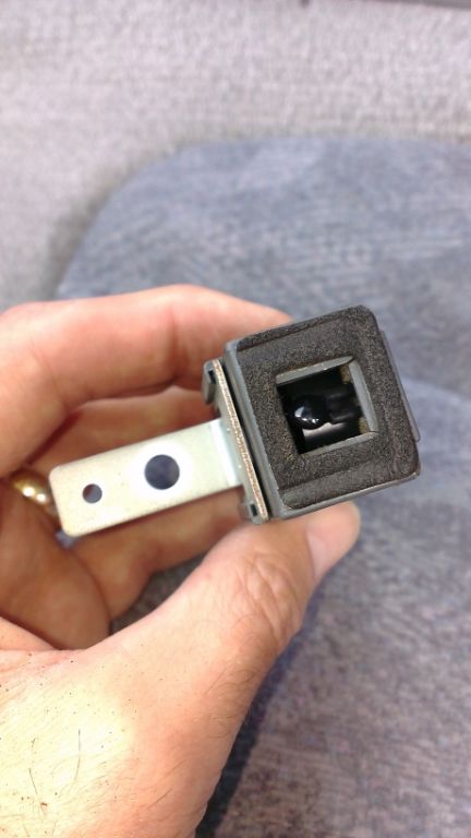

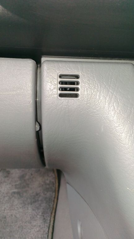

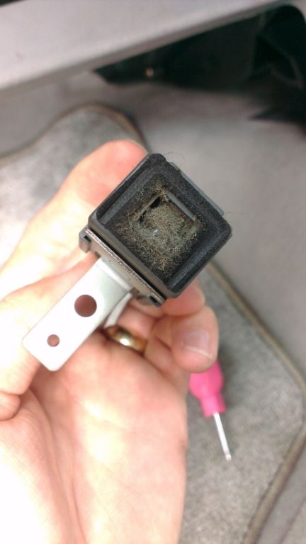

From purchase I was having an issue with the cabin heater not providing warm air until I turned it right up. Having searched around these forums, I discovered that the problem be a dirty interior thermostat.
.. well, could have been ..
Before:
After:
Seems to have done the trick :)

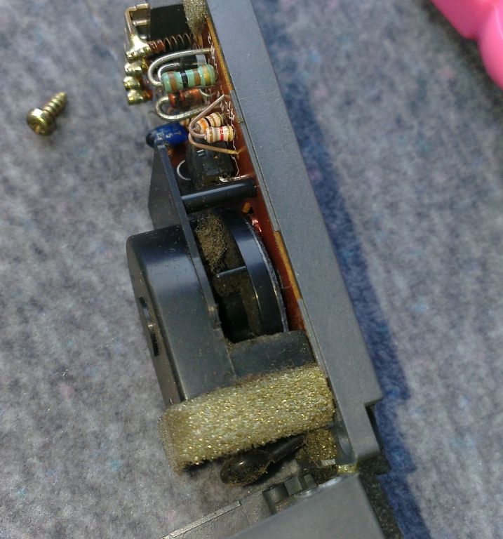

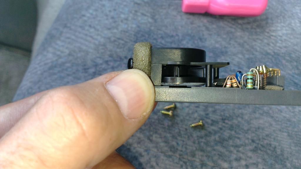

I should add that I cleaned the fan out too ..
Before:
After:

OR .. for routine cleaning blow the dust (and dog hairs) out using some aerosol compressed air (as used for cleaning computers) ..
Mark.T
Posts: 147
Joined: Mon Aug 04, 2014 10:41 am
Location: Weymouth, Dorset
Re: Interior thermostat
Post by Mark.T » Thu Sep 25, 2014 4:02 pm
That would be OK, but you'd be blowing the dust etc into the back of the housing. I doubt that would be too problematic though in realty .. unless you manged to the Bongo on the road for half a decade or something, in which case the housing would fill up with dust and stuff :)
