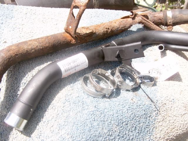

Dunno if it's relevant to the Bongo .. but I have a Toyota Estima .. being a galvanised body thay do not suffer the same rust problems as the Bongo ..
Running on LPG and not using much petrol .. I also noticed petrol smell on mine, and found the .. none galvanised steel .. filler pipe completely rotted through..
