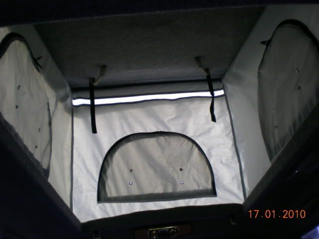

hi Ed you must have seen my first after market roof havent got it now but it was converted by elite camper conversions worksop sheffield
( not trading anymore) i had it 3 years fault less !!!!!!!! not sure what company supplied the roofs thoImageImageImageImage

Ed knows that roof well as not to long ago he fitted a full side conversion to my 2003 Tintop.
The aftermarket roof just like yours, had just been fitted by Elite.
I have to agree with Ed when he says the aftermarket roofs generally available seem to be poor quality.
Ed pointed out some really poor workmanship on the roof fitting that I previously hadn't noticed.
Ed's conversion is the best of the best and I am just glad I waited for a slot to have this done.
I had looked at about 5 other companies around the UK before deciding on Ed.
Unfortunately I still haven't found any roof that comes up to scratch.
Ed, if you manage to find one that meets your standards please let me know and I will be one of your first
customers to have mine changed.

For comparison purposes, these are a few photos of reimo roofs.
interior roof trim

Post by Colin H F » Thu Jun 27, 2013 11:20 pm
well like i said i was more than satisfied with mine i had the bongo 3 years went to loads of meets mine was the only aftermarket there which invited a lot of interest, and never met one person who had anything bad or derogatory to say about it, it fitted perfectly didn't leak stichwork was good zips worked inner fly mesh !!!!!!!!!!!!! so i don't know about the ones you guys are picking on mine was fit for purpose and that's what matters that's it said my piece
