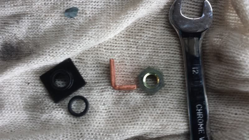

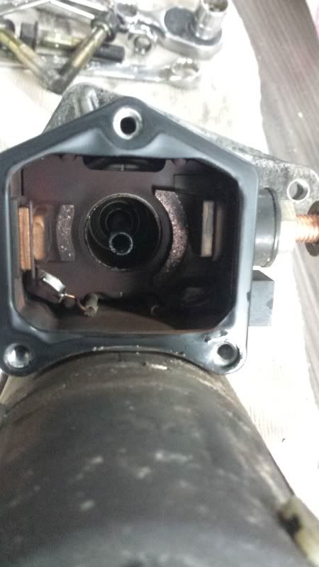

Post by stefan442 » Fri May 10, 2013 9:30 am
Contacts seem fine....? Watched the video online, very simple job.
http://i56.photobucket.com/albums/g179/ ... 091656.jpg
Have given it a clean... will put it back in and see.
Contact... other one is the same...
http://i56.photobucket.com/albums/g179/ ... 093436.jpg

Driver+Passengers
Posts: 2019
Location: Fife
Re: Poor bongo won't start
Post by Driver+Passengers » Fri May 10, 2013 9:38 am
I don't know much about the electrics, but if the battery is (still) testing fine on its own, it might yet be the alternator if you're seeing a low voltage reading while running??
Fingers crossed for the re-fit and test. ;)
