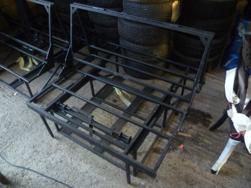

Ones like this are good, the top section rolls on the "top" of the frame, the two supports at the front don't touch the ground but allow you to mount a kickboard at the front, the lever drives two large pins in thru the frame to hold the entire seating section solidly in place.

g8dhe wrote:Ones like this are good, the top section rolls on the "top" of the frame, the two supports at the front don't touch the ground but allow you to mount a kickboard at the front, the lever drives two large pins in thru the frame to hold the entire seating section solidly in place.
Geoff, I like the look of that design. Do you know who sells them?

No I took a look for a photo on the web that matches ours, I had the above from a previous discussion, but I couldn't locate an image currently :-( I think you would find that any design that implements the two bolts approach is likely to be a pretty rugged layout. On ours the top seat runs on real ball bearing based gliders within a semi-closed channel so they are very smooth and unable to jump out, to release the gliders they have to come out the end which of course is blocked in normal operation, however that helps ensure that the seat is going to meet seat belt requirements etc.
Ours was converted by Free Spirit Auto's in West Sussex, whether he still uses the same style or not currently or not I don't know but might be worth a call to ask ?
The design does ensure that you get just about the maximum storage and when the seat is rolled forward into the bed position we store all the clobber that sits on the back seat under the now empty front section, which also means its out of sight if you need to leave the van for any extended period ;-)

Here is the one shown above:
http://www.ebay.co.uk/itm/ROCK-N-ROLL-B ... 4aa3a2493b
I bought a very basic one for mine, circa £130. If I were to do it again I'd buy the above - it uses bearings and has the stoplock built in for a good price. I mode my own locking mechanism which is fine but it's nice to have it done for you.
