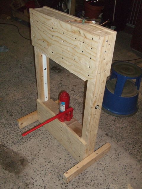

job done. Thanks for your help. I managed to get the old ball joint out by cutting a slit delicately with an angle grinder and hacksaw then knocked out the sidewall. Then to get the new ball joint in I filed down the edges of the wishbone placing a short scaffold bar over and hitting with a club hammer, was a very tight fit. I am curious of the press you built though. I wouldn't mind making my own ready for when i do the other wishbone next week.

You can buy a 6 ton press on ebay for £75 delivered, though I've seen one at £60 in the past.
Here's mine...
No idea what sort of force it will contain, but it does balljoints happily. There's more 4x2 dadoed behind the outer ply skin and then a bunch more ply above and below. Bottle jack is 8 ton, but LIDL or ALDI did a 3 ton at £10 recently, may still have stock...
Image Image

WOW very nice. I might have a go at making one at some point.Thanks for that
