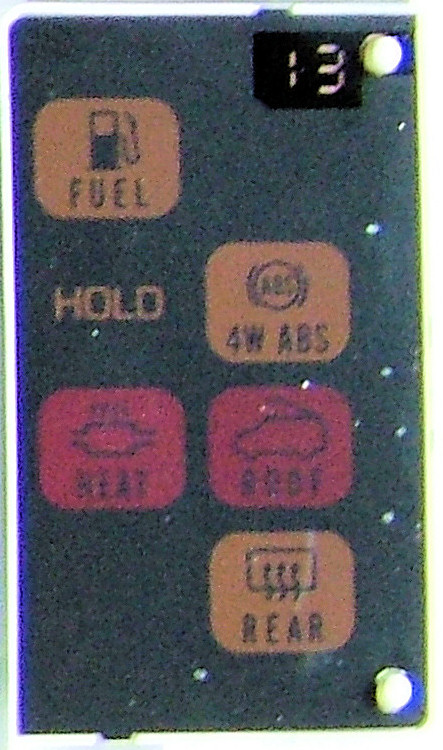

Posts: 10910
Re: Low fuel warning light
Post by g8dhe » Thu Jan 10, 2013 2:54 pm
These are the V6 warning symbols on the right;
mikeWalsall
Posts: 3075
Post by mikeWalsall » Thu Jan 10, 2013 3:20 pm
Ummm... different to my 'R' reg ..
Yellow rear window and fuel lights are on the right of the dash ... HOLD light is by the gear position ... red .. belts .. air bags .. ABS .. ignition oil etc: are to the left ..
