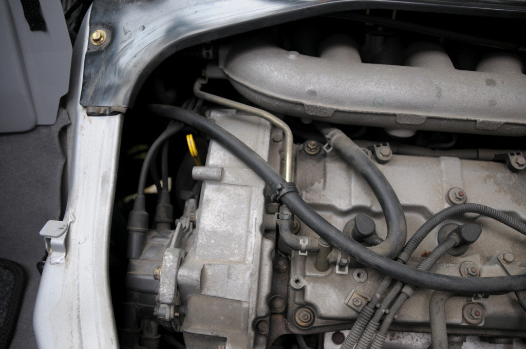

Having just taken the plunge and spent £240.00 on a new distributor,rota arm and HT leads from mazda.I thought i would check out the forum on how to fit the cap and rota arm.I have used the search function but I dont get any threads on how to do it.They all state that they have changed the cap etc.This leads me to think thats its an easy job but lifting the passenger seat it looks a nightmare do you access it from under the van?Do you remove the auto gear selector? I think I can see one screw but I think theres 3.Also the rota arm is this screwed on or dos it just pull off.I think I should be ok with the leads if I label them.

No sorry should of said ON lifting the passenger seat and then looking at the engine it does not look an easy job to change the cap and arm

No you just reach round the front of the distributor cap from the passenger side, 3 screws;
http://lushprojects.com/bongopartsmk2/c ... mgno=.html
Probably a short stubby crosshead (Phillips) screwdriver would be best, you can see one screw head visible just below the set screw for the cap position, also worth marking the position of the adjustment so you can set it back again.
