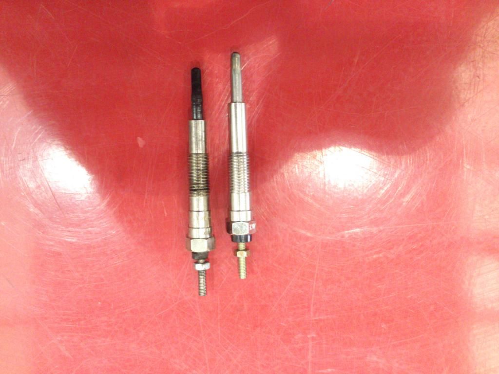

Been waiting for your reply, that sounds logical as I was unsure how far down to screw the tops on the glow plugs, plus the ones that came out were vitara ones which were much longer where they stuck out. I will post some pics for you to see the difference. Could you PM me your no. in case I need any on spot advice tomorrow. Thats if you don't mind that is.

Here is the pic of old v new, i took the pic so the threads were level as thats where they would screw in from. You can see they are quite different. I fitted the long plugs in the end as the overall length was the same.

That's not the paintwork of the Bongo you're trying to sell in the background, is it?!

I'll pretend I didn't see that last post, it's a work bench I assure you.
Re: Non starter
Hi,I would remove the plugs asap and examine them,particularly the Tips.stuc wrote:Here is the pic of old v new, i took the pic so the threads were level as thats where they would screw in from. You can see they are quite different. I fitted the long plugs in the end as the overall length was the same.

Re: Non starter
Power to the rail. Took out all 4 plugs and guess what- all knackered.

Try and get Nippon denso or NGO glow plugs,you normally find cheap ones don't last and become false econ.most decent factors stock good ones as well as cheapest,once you fit them make sure they are cutting out after initial heating.mind they do stay on for a fair period of ime good luck
Re: Non starter
Hi,was the tip of the plugs damaged,try and get plugs with the same lower dimension as the originals.stuc wrote:Power to the rail. Took out all 4 plugs and guess what- all knackered.
