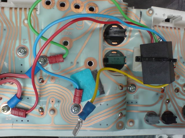

That sounds like a faulty Speedo chip to convert from Km/Hr to MpH. They are mounted behind the display;
If the chip goes faulty or gets disconnected then the Speedo stops displaying and the pulses from the Speedo to the ECU means that the ECU flags up a problem and flashes the HOLD light. Check to see if you have one and that its connected, another possibility is the actual sensor, but more common is the chip itself.

I recognise that photo ;). The wires on the left go to the low coolant alarm that I powered from the rear of the instrument panel.
