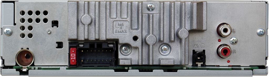

This is the rear of the Pioneer DEH-1320MP. Can anybody confirm if it's an ISO connection? It looks a bit different to the fitting on the e-bay image.
I now wonder whether this is what I need http://www.ebay.co.uk/itm/Pioneer-ISO-W ... 3ca63bb1f5
Edit again - after more searching, I think I'll need a Mazda to ISO converter and a Pioneer 16 pin to ISO converter!
There was me thinking this'd be simple!
Ta
Beyond A to B
Posts: 10841
Re: Stereo fit - Sony to Pioneer
Post by g8dhe » Tue Dec 18, 2012 11:02 pm
That doesn't look like an ISO to me! I suspect that is Pioneers own socket from the manual;
Normally they there are two 8 pin connectors arranged as 2x4 with a polarising tab to the sides;
Yup I suspect you will need both for that device ....
