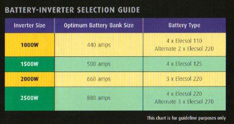

Yup and now take a look at the Elecsol data sheet, http://www.solenttech.co.uk/resources/e ... +sheet.pdf
especially page 3 and the section about Battery-Invertor selection guide;
for 1KW that's 4x110 batteries weighing 25Kg each thats 100Kilo's to carry around!
2KW is 3x220 at 49Kilos each is 150Kg ....
