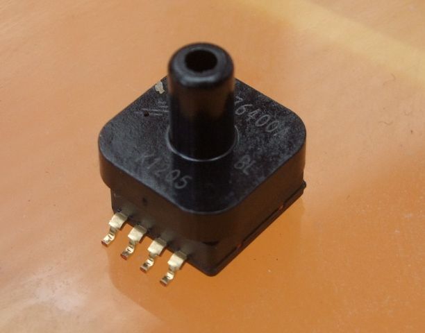

I've been having a few discussions with some members on here... I have a suspected head/gasket failure, though it's not confirmed. Before I do anything else to the coolant system, I want to install a pressure gauge.
I've just ordered 3 of these:
http://uk.farnell.com/jsp/search/produc ... ku=2080494
I'll post the build process here, and hopefully some graphs of my datalogging efforts.
Basic idea is that I'm going to epoxy the sensor into a barb connector, possibly fill the void with a dod of heavy grease, (though the part I've gone for does have a media resistant gel miniscus already), and pop it into the bleed hose. Then hook it up to an Arduino to read the voltage.

Cheers for raising that. True, but I have done my research and hopefully I'm still on the right track with this. I'd still be keen to hear what you think after reading this.Rhinoman wrote:That type of sensor is not designed for use with fluids, I would try and find one that is although when I've used them in the past they have been quite expensive.
The media resistant gel (Sifel) used in this product variant is a start. The manufacturers have additionally recommended a heavy molecular weight silicone grease barrier. I have yet to select the grease that I will use but they recommend Parker O-lube, DMS-T46 or T51. In terms of contaminants, the grease must be free of halogenures (Cl content < 50 ppm). I don't know what that means yet.
They have also referred me to an application note http://www.freescale.com/files/sensors/ ... AN3728.pdf and the "Quality and Reliability" and "Sensor Media Compatibility" sections of their Device Data Handbook http://cache.freescale.com/files/sensor ... /DL200.pdf (25MB).
I am aware that this sensor measures pressure relative to a sealed vacuum, whereas I really want a differential pressure sensor with one port open to atmosphere. I could always use two and compensate in software.

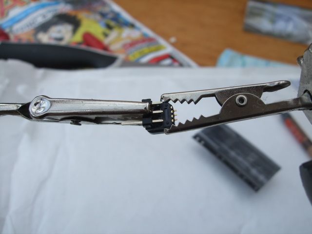

I've clipped off the N/C pins from the chip, shaved off the pimples on the bottom of the package and epoxied onto it a 0.1" pitch, three pin connector. No locking tab, so I'll use a zip-tie on the final assembly as strain relief. When it's dry, I'll solder on short link wires, test it and then encase the bottom in hot glue.
