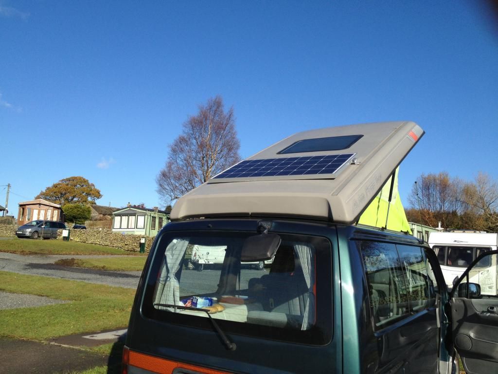

Here is one I did recently...(along with rewiring the Mazda kitchen, installing a leisure battery, a Willington Kit, and a Low coolant alarm - was a busy morning!)

My Bongo above!!
Roger installed the kit for me just in the tail end of summer, has been working really well. Can't wait for summer now as I think the panel will provide enough juice to keep the fridge running almost constantly! Awesome work on the other bits too :)
