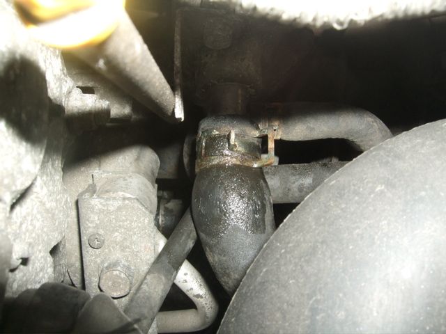

Driver+Passengers wrote:I believe this is what you might call a coolant hose that is "on it's way out".
Thanks to Peter and Dave for helping me out today!
After taking (cutting) this hose off, it was quite clear that the reenforcing string was absent from the ballooned section - suspect that once liquid penetrates the wall it rots away and the hose then balloons. ?
