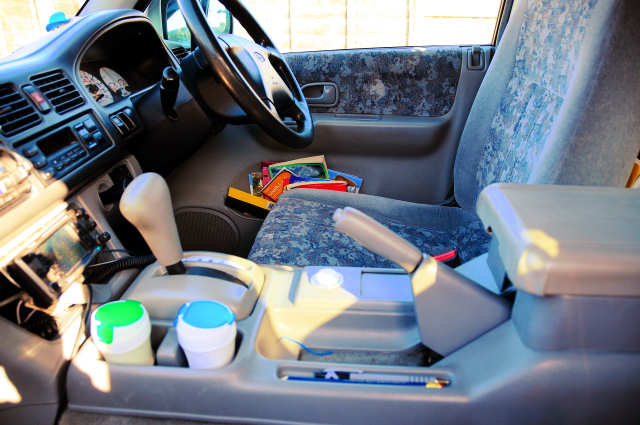

Yes fitting radio's is not too bad, just the usual precautions on power cable sizes depending where you fit the units, my 2m/70cms rig is shown here;
The head unit is hinged inside the central cubby hole in the dash, just in front of the gear lever, so it can be tucked away when not in use, its also my Rear and Forward view camera display;
Image Image

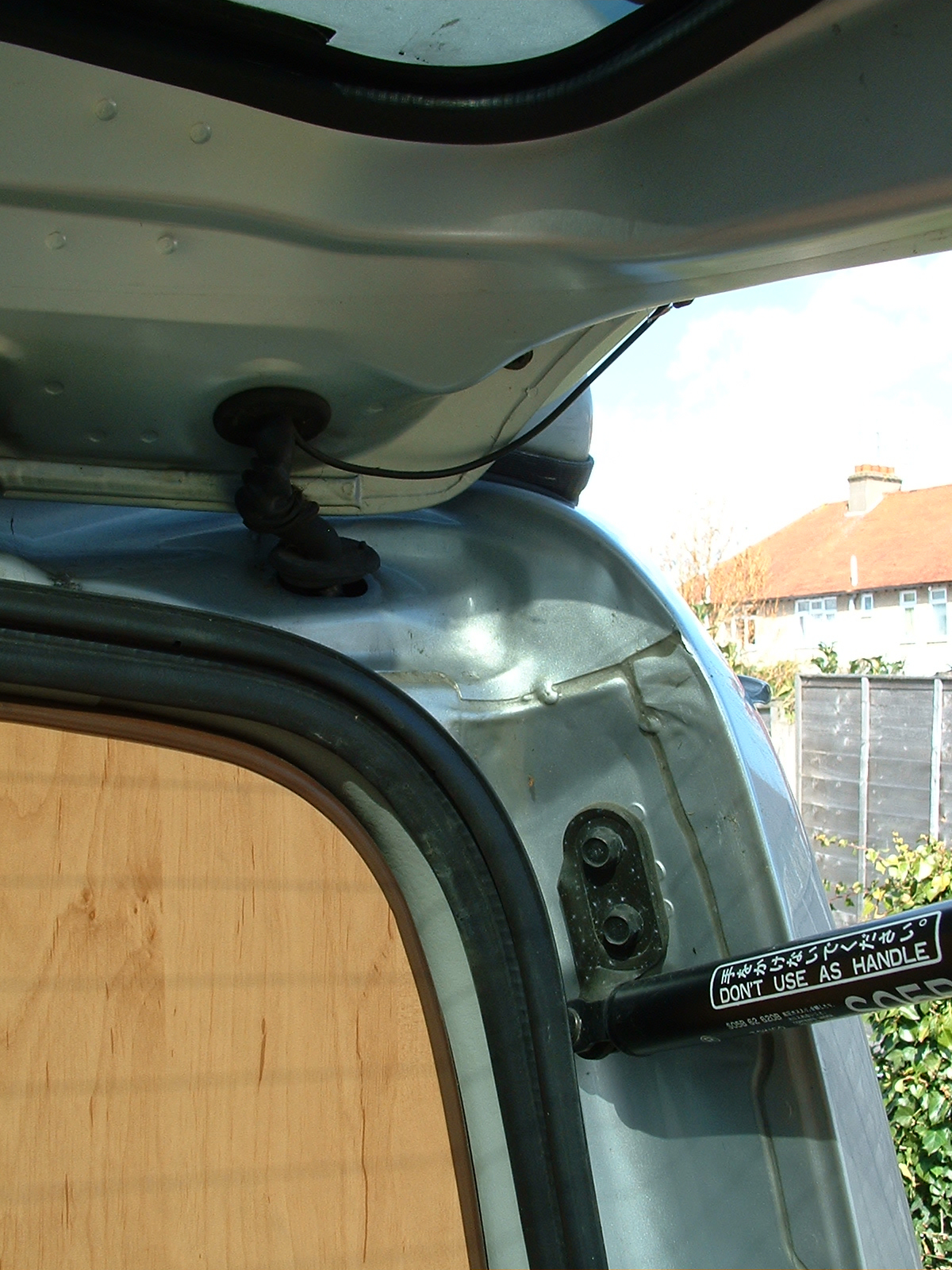

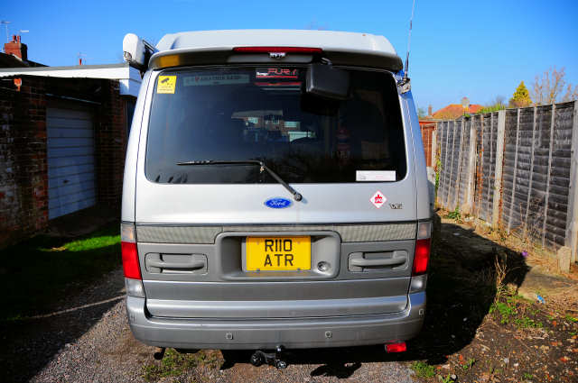

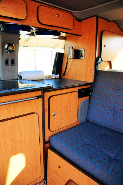

The main unit is mounted to the top of one of the storage cupboards in the side conversion next to the Zig power unit, that way I can always plug the Mic in there directly when sitting in the back! The aerial mount is a standard boot mount type on the rear door, with the cable run inside;
Image Image

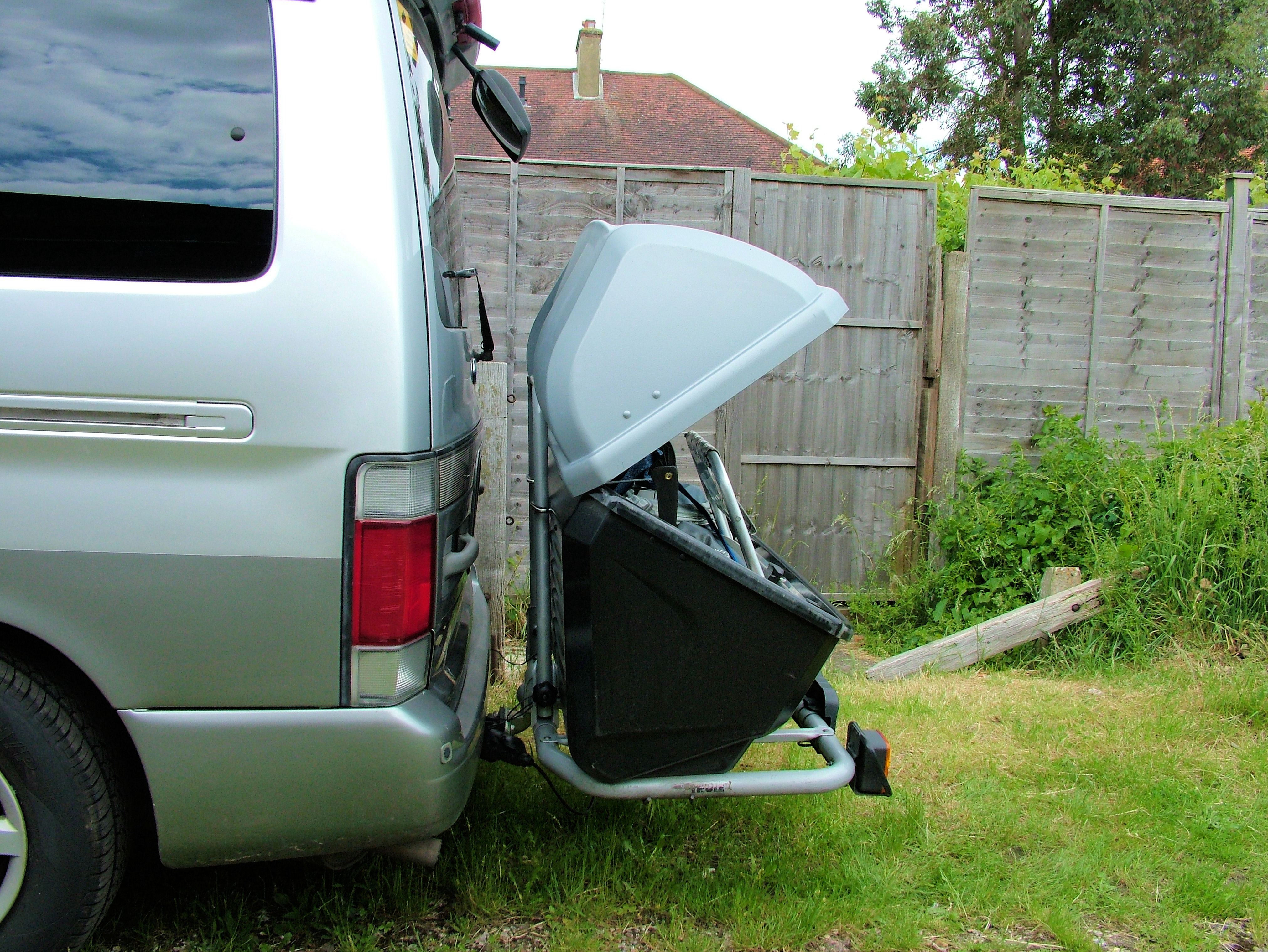

The Thule carrier 901 fits on the Towbar, and you can swap what goes on the carrier around, but it has a very nice rear support unit which is quite strong, which also swivels downwards to make life easy, click for larger images on the photo's!
Image Image
