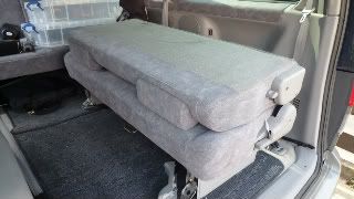

The weather is fine so I geared myself up for it. After pulling back the panel it was obvious the whole thing has to come off to make it an easier affair so out came the rear seats.

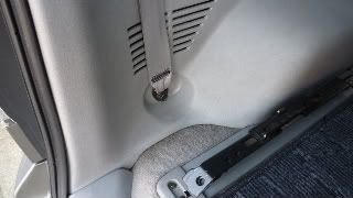

The side panel just pulls off after removing the rear seatbelt bolt.

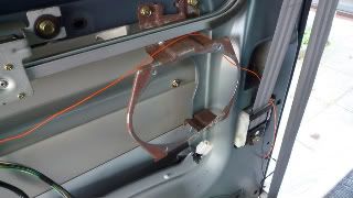

Disconnect the switch connector,
and the cigarette lighter connector and pull off the panel.
Take a picture of your new speaker box like so...

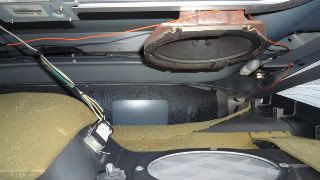

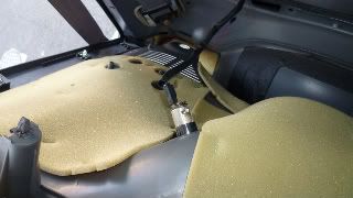

There are just 4 self tapping screws holding the nasty old speaker in place so unscrew them and disconnect the speaker connector.
Make a little wiring loom to connect the mazda connector to the new speaker and screw in place. Simples.
And behold the new speaker in place. The beauty is when the panel is reinstalled the is a few mm's gap between the grill and the tweeter. No cutting required.

One small question Spud..
The cheap speakers i currently have in the rear i fitted a couple of years back on account of no factory speakers... Though wiring loom was strangely there..
My memory is not so good as to what's behind the panel... Was there a bracket for the factory speakers on yours? Or did they screw directly into a designated space on the framework behind the panel...?
Difficult to see on the photo's...

If you look at pic 6 you can see what the speaker screws to. It's the rusty thing and is a bracket held on with 3 bolts. It was already there and almost certainly from the factory. I'm not sure how better to describe it than the pic. At that end you can pull your panel partially away and just peek down to see if yours has them.
