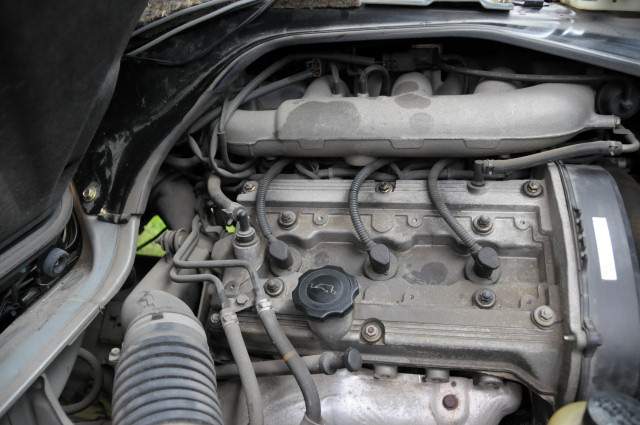

Its shown here as 19-880, its the similar on all types but not sure if oil capacity is identical, under the drivers seat running up from the lower rear to about midpoint of the engine http://lushprojects.com/bongopartsmk2/c ... mgno=.html
On the V6 its here in the foreground just below the oil filler cap.

No real idea of the length Ady, I just looked at the Lush diagrams and had a photo of my own engine.

I've had another grope under the drivers seat and now found the dipstick. I've been converted to LPG, and the injectors are mounted directly over the dipstick obscuring it. The pointer in the photo of the V6 was the shape of the "handle" at the end of the dipstick. I was looking for a wire loop type arrangement as on the end of the engine dipstick.
