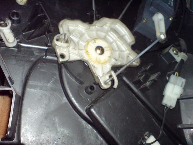

Posts: 10974
Re: front heater wont switch off?
Post by g8dhe » Thu Feb 16, 2012 12:19 am
Could be the old links broken, check in the drivers footwell;
