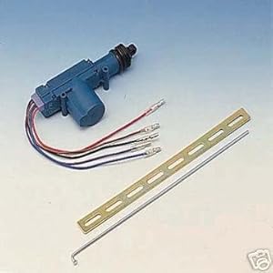

Plus the clip mounting points breaking on the actual panel...!
(Where the the long jutty bits attach just below the curtain track/window ledge?) I actually successfully strengthened & repaired about four of them using a cut length of the bracket thing that comes with an after-market solenoid, then bent to shape....
The metal bit between the rod & the solenoid.
