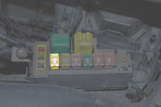

						Re: Intermittent cutting out
If your gauges Temp, Fuel & Rev's drop back that suggests an electrical problem, which could well include dropping the Fuel solenoid as well.  Try checking the 100Amp main and 60 Amp Ignition fuses;
