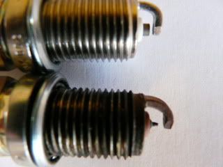

When I first got the V6 12 months ago it had a slight misfire when on LPG.......new plugs/dizzy cap/rota later it was "almost" cured. (ran lovely on petrol)
The rota seemed to be the item that had the most effect.
9,000 miles later and the misfire came back and worse every day (LPG only)
Fitted a new dizzy cap/rota and little differance although the contacts in the cap were badly burnt....
Phoned Paul at LPG Imports and he said check the Plugs....the LPG is very hard on them.
Not fitted the new ones yet....(waiting for a bit of copper grease)
Think Paul could well be right.....will let you know.
All plugs were exactly the same with a 1.20mm gap

the lower plug looks to be an irridium one. In mine I found the irridium (IK16 from memory) the best for starting and running, however they are very pricey.
I dropped back to standard NGK ones and just changed them every year as they are pretty cheap, I did reduce the gaps by 10% from recommended as this helps too.
Hope the plugs fix the problem. All good otherwise?

Hi Hayden,
Correct ????

haydn callow wrote:When I first got the V6 12 months ago it had a slight misfire when on LPG.......new plugs/dizzy cap/rota later it was "almost" cured. (ran lovely on petrol)
I did not realize that the lower plug anode is ment to be shaped to a point..
So perhaps the fault is not with them...I will fit the new ones to-day and see what happens

Fitted the new plugs and got a road test .....fingers crossed ...all now good...
