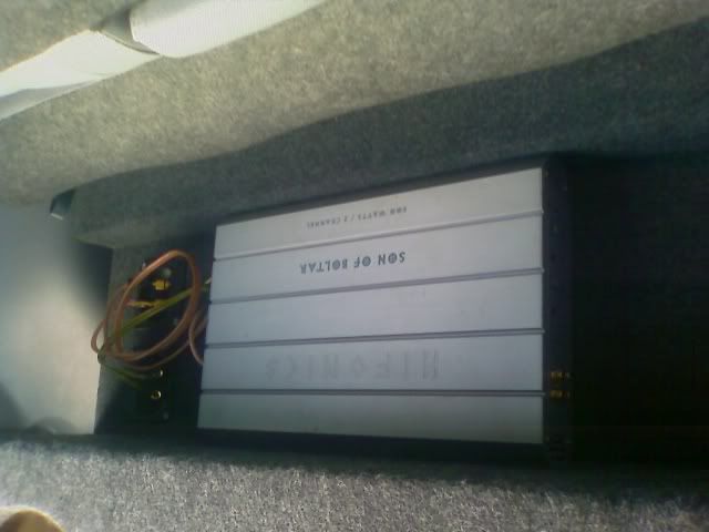

I'm enjoying this thread! I remember (years ago) after spending an entire wet, dreary sunday stripping out the bongo to fit a sound system "had i gone too far on an MPV"?
Plenty of people looked surprised to see (or hear) that it was a bongo BOOM BOOM BOOMING down the road!
A few odd piccies of my set-up (i'm fluffed if i can remember how i wired/set that lot up though)
Two channel (bridged) amp at the rear of the drivers seat driving my single sub, there's a 4 channel amp driving four mid range 3 ways via a dedicated crossover network, 4 "tune up" tweeters are driven by the head unit directly....And there is a line out ready for another pair of speakers for if/when i decide to fit more...At the moment i have 8 speakers and 1 sub... Set up for a quality sound rather than just mere power, getting the balance just right can take months...Tweaking a knob here, adjusting a level there
And the objects in the rear cupboard get an earbashing too!
A bit messy when installing...
